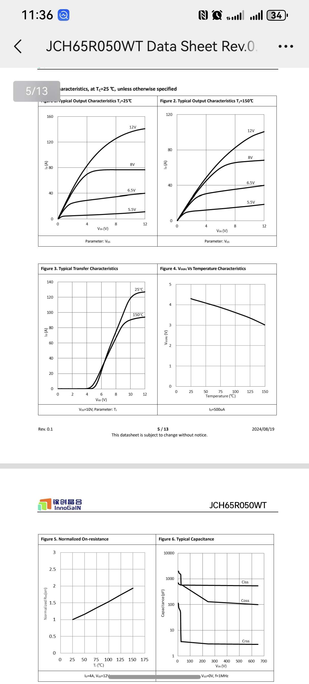

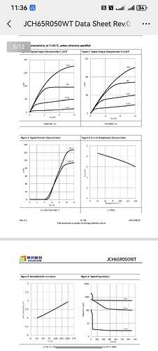

帮忙推荐下, Totem PFC方案,快支路(fast leg)驱动Cascode D-GaN的栅极隔离驱动器, D-MODE GaN参数(VDSS:650V, RDS(ON):50mΩ, QG:12nC, QRR:127nC, ID:38A, 请帮忙推荐驱动 cascode D-MODE GaN的驱动器
,谢谢.
