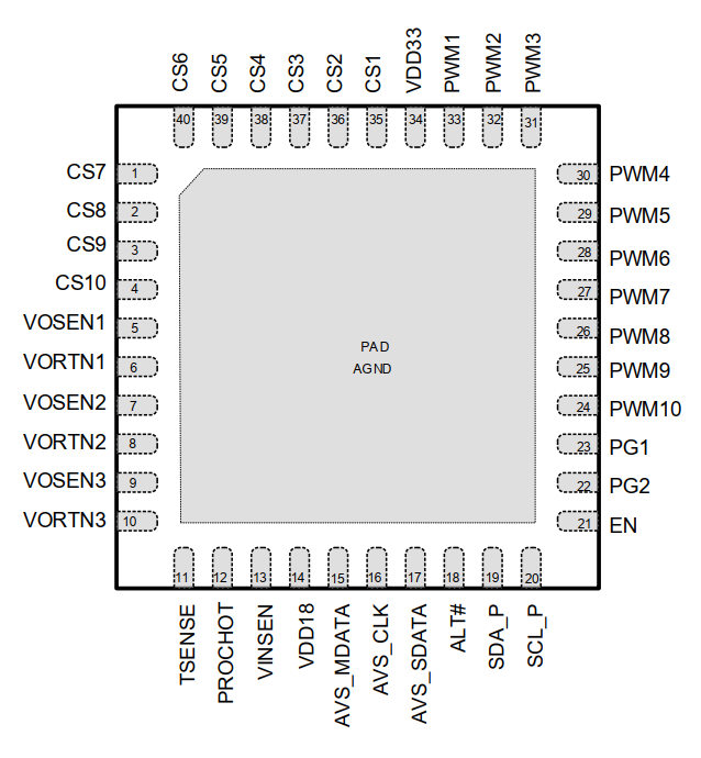

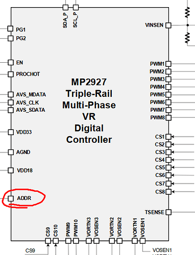

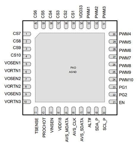

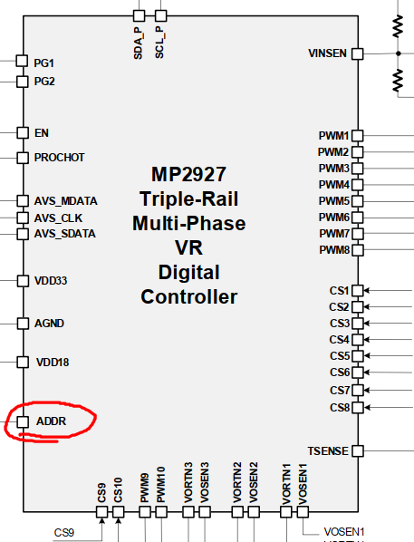

ADDR in first picture does not appear in the second picture which is the package of this chip.So who’s right?
MP2927 PMBUS ADDR just can use register mode to config, you can refer to PIN map, first picture is topo error, thanks.
